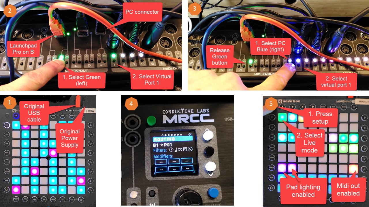

Step 1:
Connect Launchpad Pro with Power Supply and Orginal USB-B cable to the MRCC
Connect the USB cable from the Launchpad to one of the USB connectors of the MRCC. In the pictures, my Launchpad is connected to B.
Connect the USB cable from the PC to the PC connector of the MRCC.
Step 2:
Select and hold the green button of the MIDI IN/OUT connection of the Launchpad and select Virtual Port 1.
Release the green button of the Lauchpad connection.
Step 3:
Make sure that the green button of the Lauchpad connection is still lit.
Select and hold the blue button of the PC connection and select virtual port 1 (out of 12). Make sure all other virtual ports are NOT connected.
Step 4:
Verify the routing. In my setup B is connected to P01
Now the Launchpad is connected to the PC.
Step 5:
Set the Launchpad in the Live mode and make sure the Midi In and Midi Out buttons are lit in the setup.
Press Setup button
Check the Midi in and Midi out pad lightning settings
https://support.novationmusic.com/hc/en-...nchpad-Pro
Both need to be enabled to see any lightning response from midi and when you press the buttons on the launchpad.
Select the Live Mode and the Launchpad will restart.
Step 6
The Launchpad Pro will restart in the Live Mode and you can try to press some buttons on the Launchpad.
Step 7
The main area is dark and only the buttons pressed light up with random colors.
