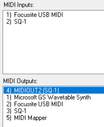

Hello again,
i connected the KORG SQ-1 via usb host and it doesn't recieve any clock or start/stop signals.
I tried MRCC's clock generator and external clock via midi.
Help please =)

There is bidirectional midi via usb.
I can plug the SQ-1 in my computer and can send sync and start/stop via my daw. =)

OK. The manual makes no mention of receiving incoming MIDI data, so I downloaded the MIDI Implementation Chart and can see that it does respond to clock in and start/stop via USB MIDI. I have no idea why you are having such difficulties. Sorry, tried to help.
